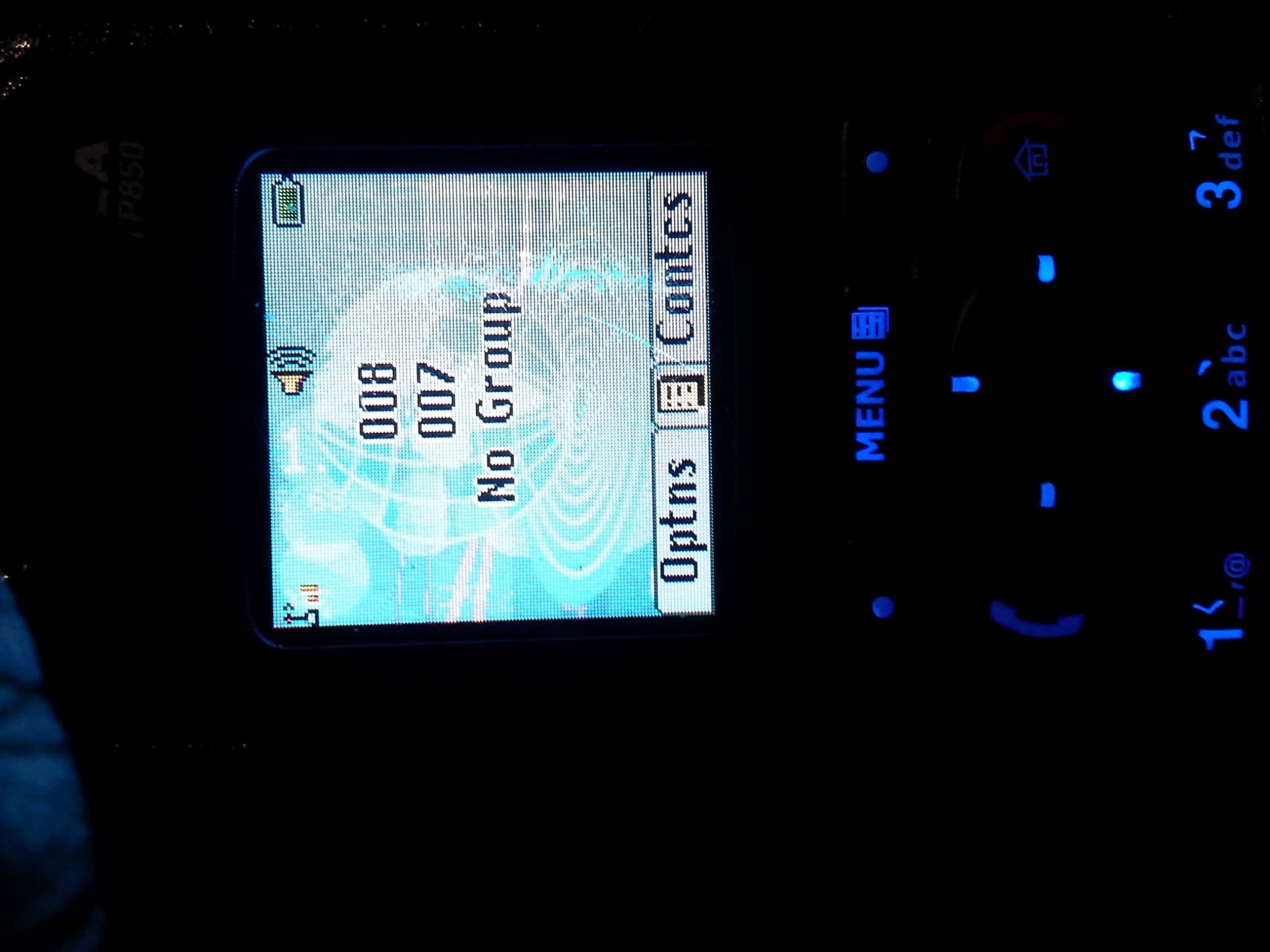

    DMO can only work
Hits:	284

    WE NEED MORE INFORMATION FROM YOU! Otherwise NOBODY can help you !!!
    radioman2288 Gast
    Not necessary! I only use DMO Mode.thank

    Zitat Zitat von radioman2288 Beitrag anzeigen
    DMO can only work
    Should this be DMO mode? The icon left to the battery status (like "|->|") is missing. So you are in TMO mode with a network in range, told by the Rx quality...
    Sure you are in DMO mode?
    Sure you have no active network in range?
    Sure you got this anywhere from ebay?
